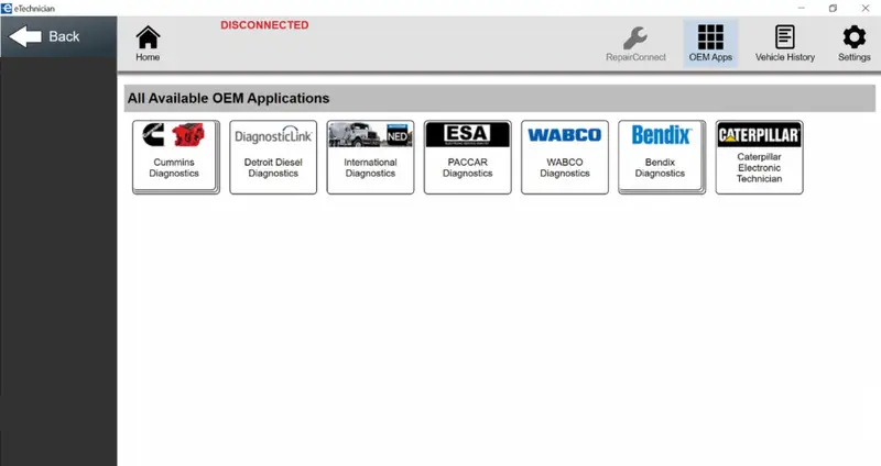

Coverage: Engines
o PSI Engines (Supports the following Power Solutions International® engines using the MT88 Engine Control Module: 6.0L and 8.8L gas, 8.8L LPG, and 8.8L CNG)
o Cummins Engines: EPA ’07, ’10, ’13, and ’17; Pre-EPA ’07; and natural gas engines
o Detroit Diesel: DDEC 6, 10, 13, 16 (2007 - 2021)
o Detroit Diesel: DDEC II, III, IV, V (1987 - 2006)
o Detroit Diesel MBE: (2001 - 2006)
o CAT Engines with ACERT Technology: (2003 - 2009)
o Caterpillar Electronic Engines: (1990 - 2003)
o Navistar MaxxForce: (2007 - 2020)
o International Engines: (1994 - 2006)
o Volvo and Mack Electronic Engines: (EPA ’07, ’10, ‘13, and '17)
o PACCAR MX Engines: (EPA ‘10 and EPA’13)
o Hino Engines: (2005 - Current)

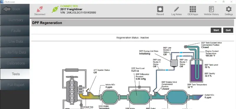

Cummins: Bi-Directional Support (Partial Listing)
o Cylinder Cutout for EPA 2002 to Current (ISB, ISC, ISL, ISM, & ISX)
o DPF Stationary Regen for EPA 2007 to Current (ISB, ISC, ISL, ISM, ISX)
o Trip Reset for EPA 2007 to Current (All ECUs)
o Aftertreatment Reset for EPA 2007 to Current (All ECUs)
o Fuel Injector Reset for EPA 2013 to Current (All ECUs)
o Fuel Leakage Test for EPA10 to Current
o Fuel Injector Calibration EPA 2007 & EPA 2010 (All ECUs)
o VGT Actuator Installation & Calibration EPA 2010 to Current
o VGT Hysterias Test for EPA 2010 to Current
o DEF Doser Pump Override for EPA 2010 to Current
o Change Road Speed, Cruise Speed, and Idle Shutdown Timer for EPA 2007 to Current
o DEF System Leak Test (EPA 10 ISB/ISC/ISL/ISX & EPA 13 ISB/ISL/ISX)

Detroit Diesel: Bi-Directional Support (Partial Listing)
o Cylinder Cutout for 2000 to 2014
o DPF Service Regen for EPA 2007 to Current
o SCR System Output Component Tests for EPA 2010 to 2013
o SCR ADS Self Check for EPA2013 to Current
o DPF Ash Accumulator Reset for EPA 2010 to Current
o Idle Shutdown Timer EPA 2010 to Current
o Cruise Speed Limit Changes for EPA 2010 to Current
o Road Speed Limit Changes for EPA 2010 to Current
o DEF Quantity Test for EPA 2010 to Current
