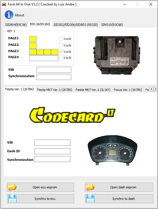

Ford All in One is a program that allow you to access the Ford IMMO dump to edit the dump file.You can use Ford All in One to get the your Ford car immo data,and according to the immo data,you are allowed to add keys…
After pressing "synchro to ecu" or "synchro to dash" (and the file saved) the software
must be restarted or it will show the old synchronization code on the file saved.

How to use this program:
- if car transponder key is lost:
read with CarProg instrument cluster EEPROM by OBDII (or you can remove IC from car and read HC12 processor EEPROM with
any programmer (like CarProg, XPROG OR UPA), save file and open it with "Open IC dump".Program will show you transponder
data.Write this data to EH2 or TPX2 transponder with any transponder programmer (like RW4, Codereader or Zedbull).
If immobilizer lamp is ON, motor ECU is defective/lost:
Open ECU(SID804,EDC16,SID206,SIM210) and read EEPROM (with CarProg you can read in-circuit).
Open file with "Open ECU EEPROM" button. Now press button Synchro to ecu (if you want to transfer data from dashboard to
ecu) or Synchro to Dash(if you want to transfer data from ecu to dash) and write saved file to dash(if you done synchro to dash)
or ecu (if you done synchro to ecu)
How does immobilizer work on Ford Mondeo 2008+, Galaxy 2008+, S-max 2008+:
Immobilizer data (PATS) on these cars are stored in the Intelligent power distribution module (GEM) located in passenger
compartment fuse box. GEM receive transponder key signal from immobilizer coil and if the key data is equal to car, GEM sends
synchronization signal to motor ECU.
If transponder key is stored in GEM and synchronization data GEM-ECU is correct, GEM permits to start the engine.
If car transponder key is lost:
1. Remove GEM (Intelligent power distribution module) from car.
2. Open and locate 25320 EEPROM. Read (with CarProg you can read in-circuit).
3. Save file and open with "Open GEM EEPROM". Program will show you transponder data.
4. Write this data to EH2 or TPX2 transponder with any transponder programmer (like RW4, Codereader or Zedbull)
If motor ECU is defective/lost:.
1. Remove GEM (Intelligent power distribution module) from the car.
4. Open ECU and read EEPROM.
5. Open file with "Open ECU EEPROM" button.
6. Now transfer synchronization data from GEM to motor ECU using button Synchro to ecu.
7. Save ECU file and write it back to Engine Control Module
